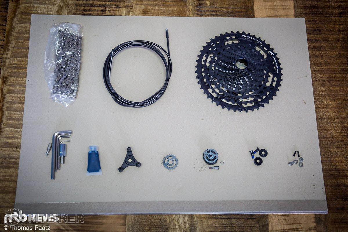

https://www.mtb-news.de/news/2018/06/25/e-thirteen-trs-plus-12-fach-upgrade-kit/
a aj tu: https://www.pinkbike.com/news/review-e13-trs-plus-12-speed-upgrade-kit.html
https://www.youtube.com/watch?v=_BLEEnDkdb4

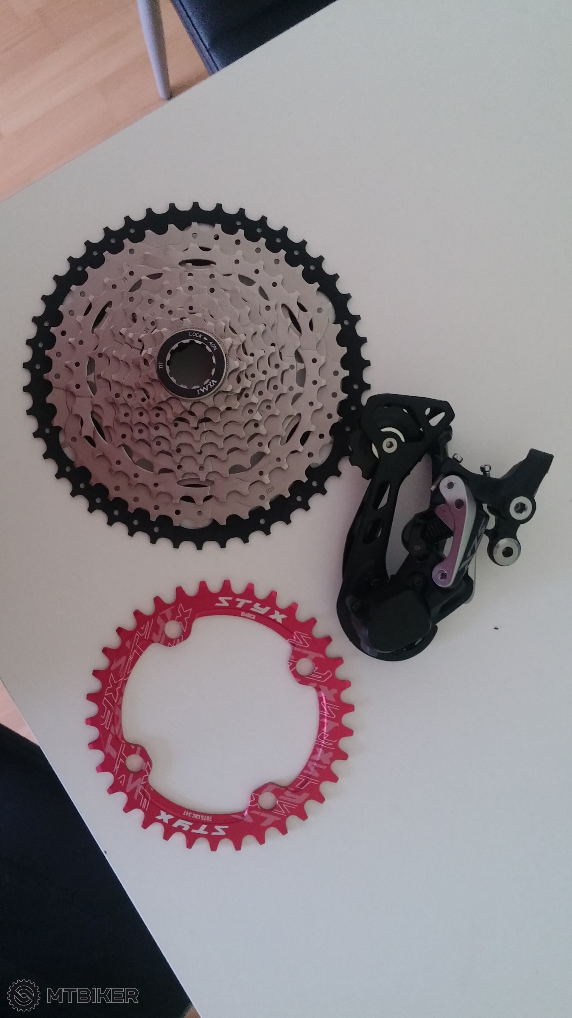

Prevodnik 34z.
Kazeta 11-46z. 10s.
Prehadzovacka slx rd-m 7000 11 gs
Prevodnik 34z.
Kazeta 11-46z. 10s.
Mas na tu cinsku kazetu nejaku overenu referenciu, ci ides testovat Ty?
