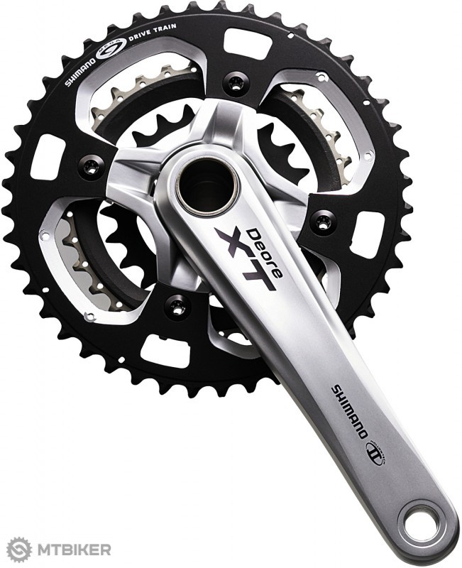

http://shop.dolekop.com/kliky-horske-110/Shimano-XT-FC-M785-2x10-kliky-38-24z.-cerne.html
http://shop.dolekop.com/kliky-horske-110/Shimano-Deore-FC-M615-2x10-kliky-38-24z.html
