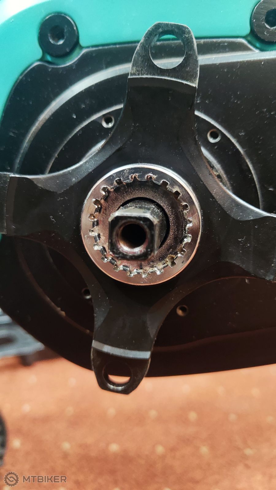

Musim vymenit osku a narazil som.
mozno toto ale nie som si isty
https://www.decathlon.sk/p/100520-94338-stahovak-stredoveho-zlozenia-hranate-osi-octalink-isis.html
https://www.greenbikekit.com/ebike-repair-parts-replacement-accessories/ebike-kit-parts/electric-bicycle-b-b-axle-wrench-tools.html
