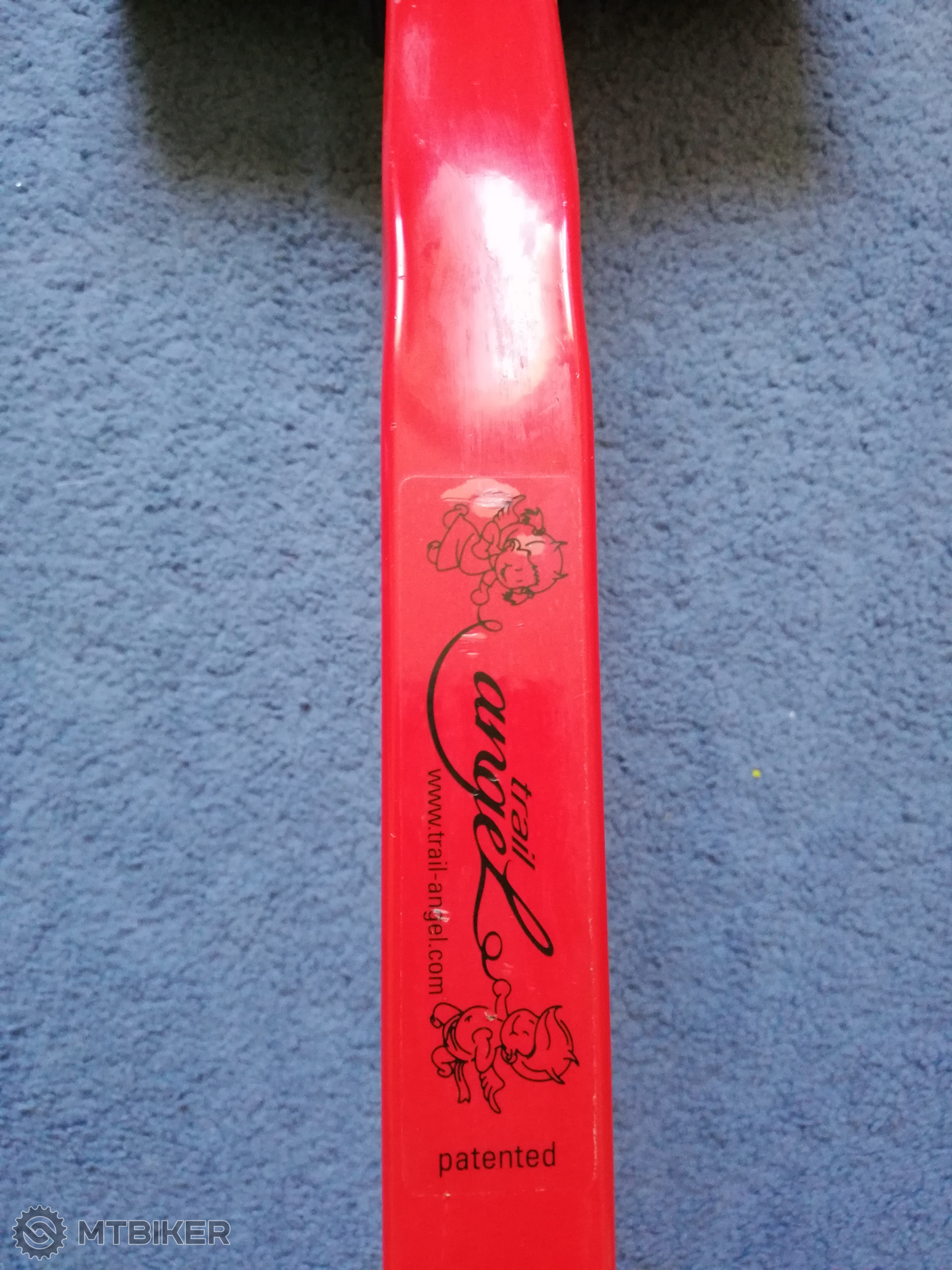

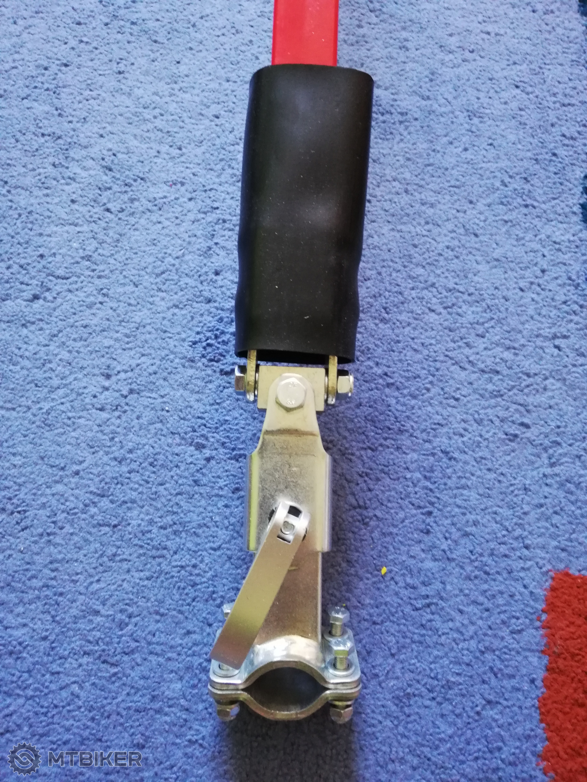

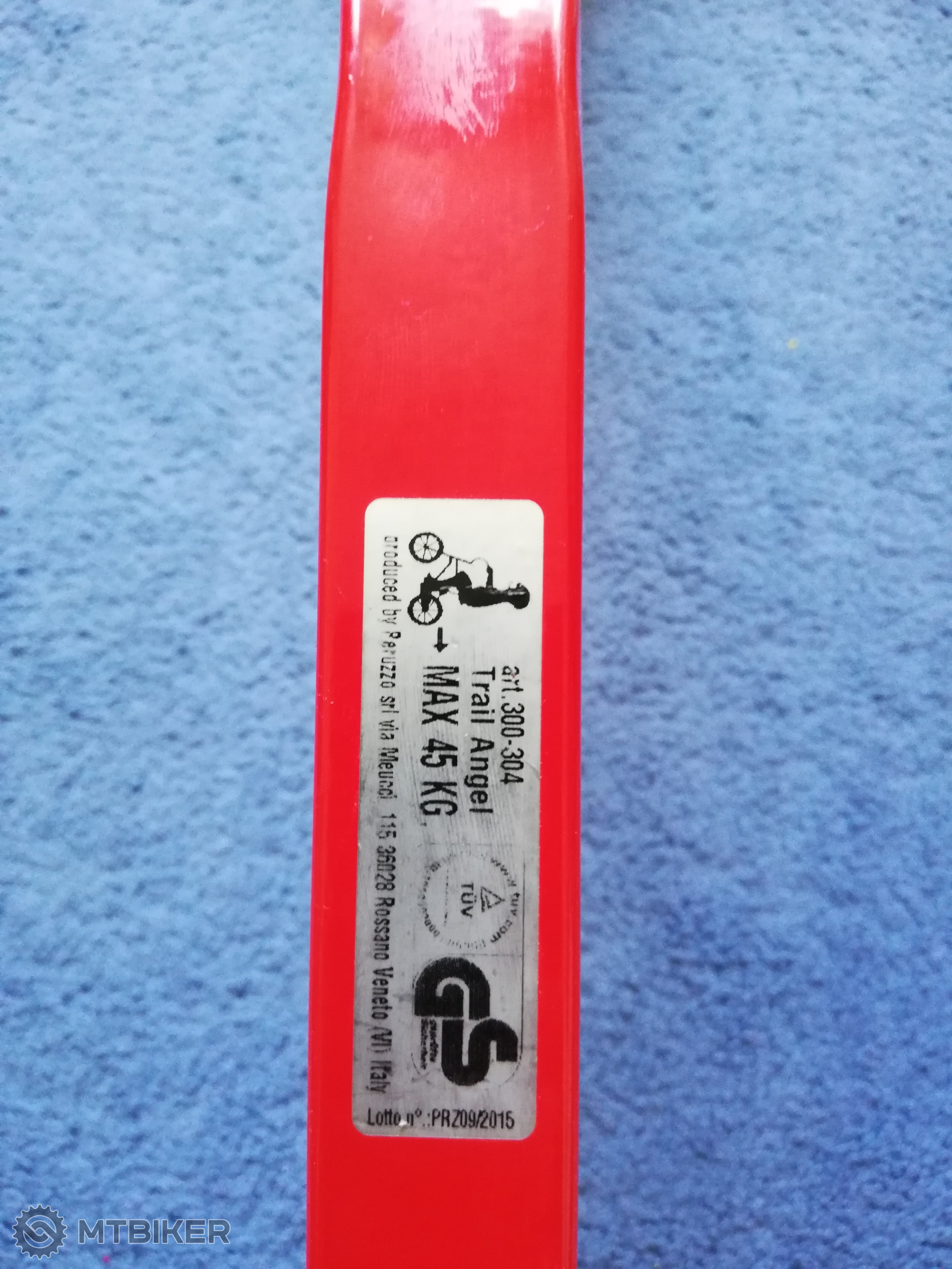

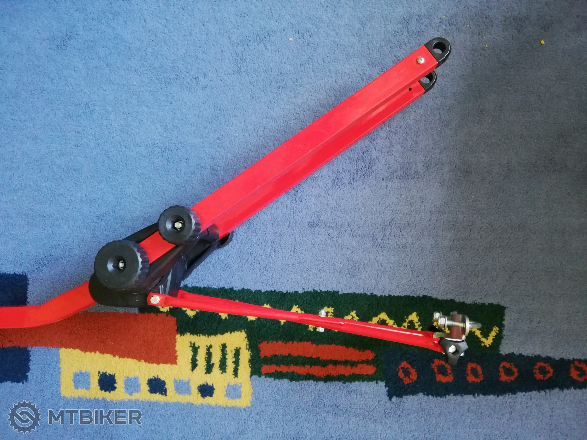

https://www.mtbiker.sk/shop/prislusenstvo/detske-sedacky-a-voziky/peruzzo-prepojovacie-rameno-trail-angel.html
cena pre foristov 40e
