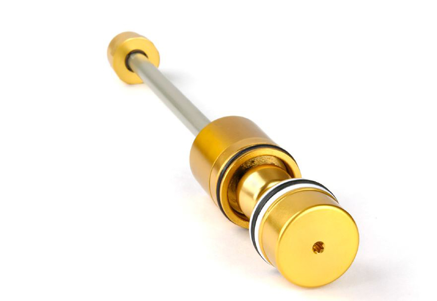

A je to tu... Luftkappe od rock shox s nazvom DEBONAIR+ :D... kurdemole, mam doma airshaft B1, nedavmo som kupil na skusanie C1 a teraz mam kupit zas debonair+ :D....
DebonAir+ is built to strike the perfect balance of what riders really want: butter-like small bump feel, increased support throughout the travel, and higher overall ride height for more confidence when things get steep.
