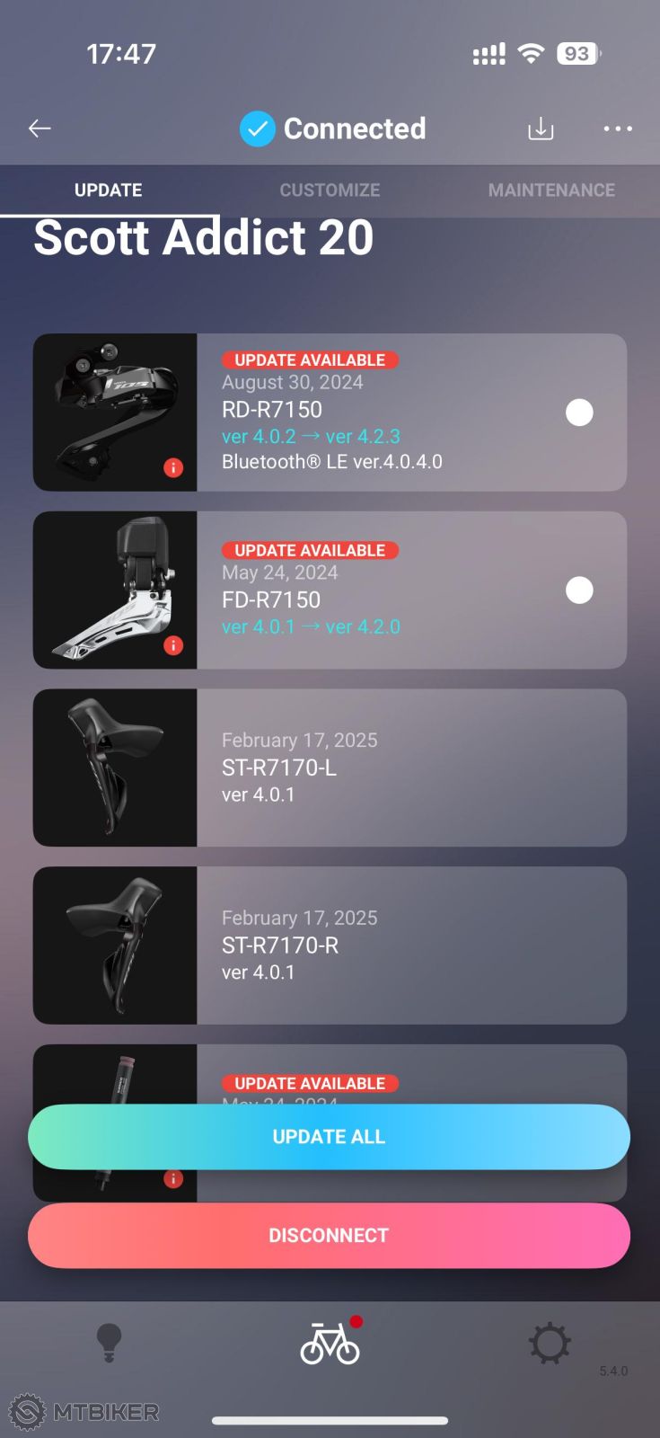

aby sa mi nestalo, že dám update a v procese to bude požadovať kábel, ktorý nemám a celé di2 ostane bricknuté
Všetko musí byť pri update FW pripojené káblom na baterku.
Na 1. príspevok za 5 rokov nemusíš strieľať mimo terča.
Na baterku musia byt pripojene samozrejme bsetky, akoby asi zili a komunikovali, ale paky cez etube z mobilu updatnut nevies. Minimalne nie ultegrove (8170, ci jake maju oznacenie). Takze ak netusis, nekomentuj.
Dovi, dopo...
Mozno myslis ten sm-pce tool, s ktorym vies updatnut paky, ale chalan ukazuje screenshoot z mobilu, a tym updatne baterku, presmyk, prehadzovacku, ale paky nie. Preto sa pytal, ci nevadi, ak jednotlive veci budu na toznych verziach - nie , nevadi. Inak by som dva roky nejazdil s pakami na 4.0.1 ako prisli, a zbytok pribezne uogradujem z telefonu. Papa
Connect your shift lever to the battery
This method is great if you can easily get to your battery. Most bike manufacturers put the battery in the seat post, and therefore getting to the battery is pretty easy.
Note down your saddle height if you haven't already, then take out the seat post to get to the battery.
Now take a long (1200mm - 1600mm) EW-SD300 wire. Plug one end into the battery and the other into the shift lever you want to update.
You can now use the mobile app to update your shift lever.
Note that if the E-Tube Project app is not registering the newly wired connection, you can fix this by disconnecting the app and then reconnecting to the bike.
Update the shifter, repeat the process for the other lever, and you're done.
"The mobile app communicates with the Di2 system through the rear derailleur, and it cannot connect to the levers directly. Furthermore, it seems the levers are only capable of receiving a limited set of signals or instructions.. and updating firmware is not part of that."
