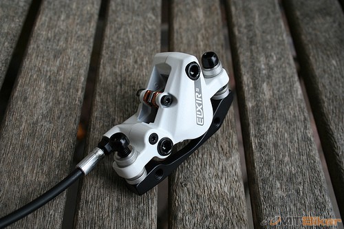

Toto je prasa:
4032606385_d876cdf21c.jpg 109.08 KiB thumb_up0thumb_down
