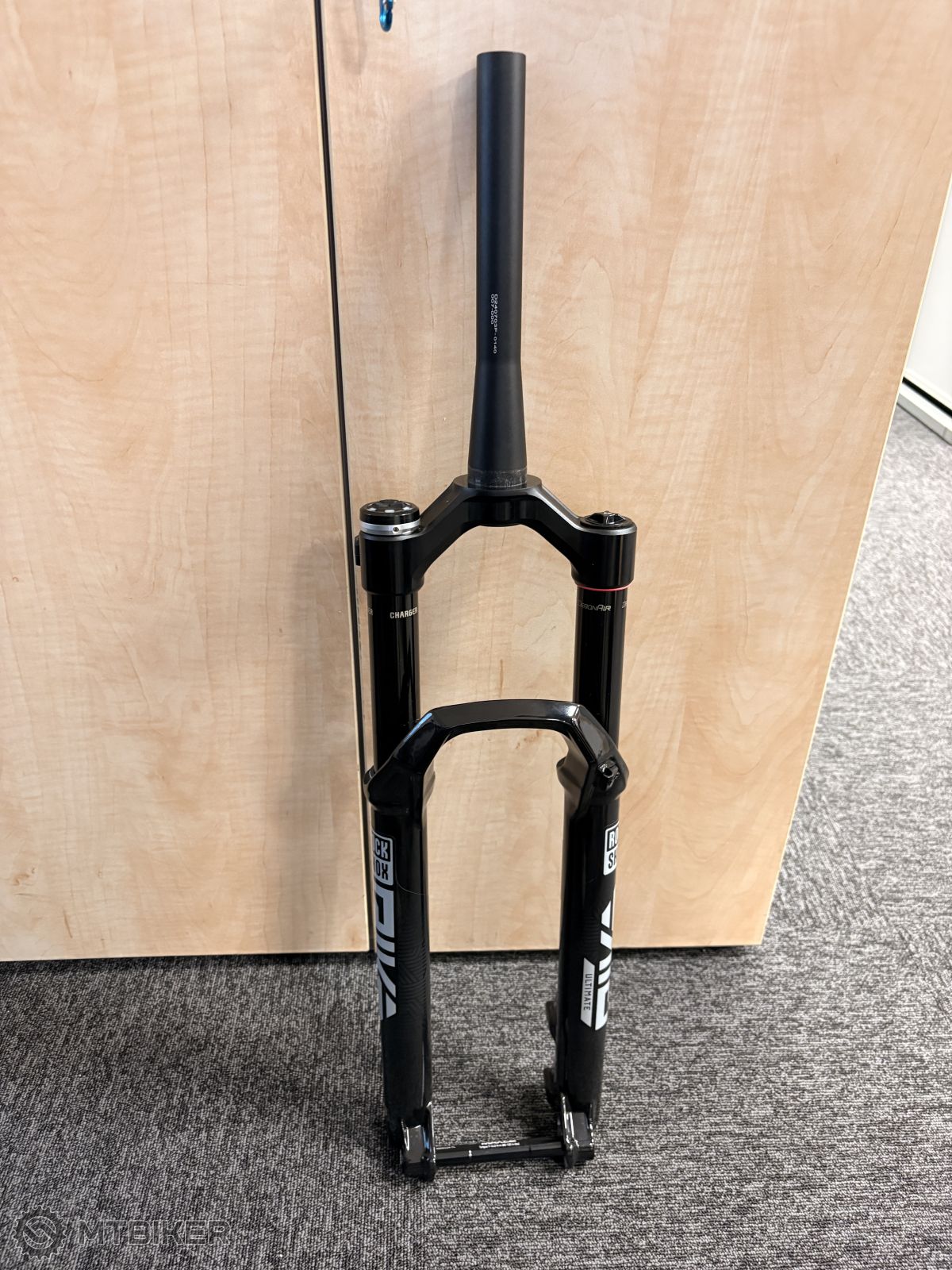

RockShox Pike Ultimate Flight Attendant C2 140mm

Do prdele,riadne dlhé meno😀.
