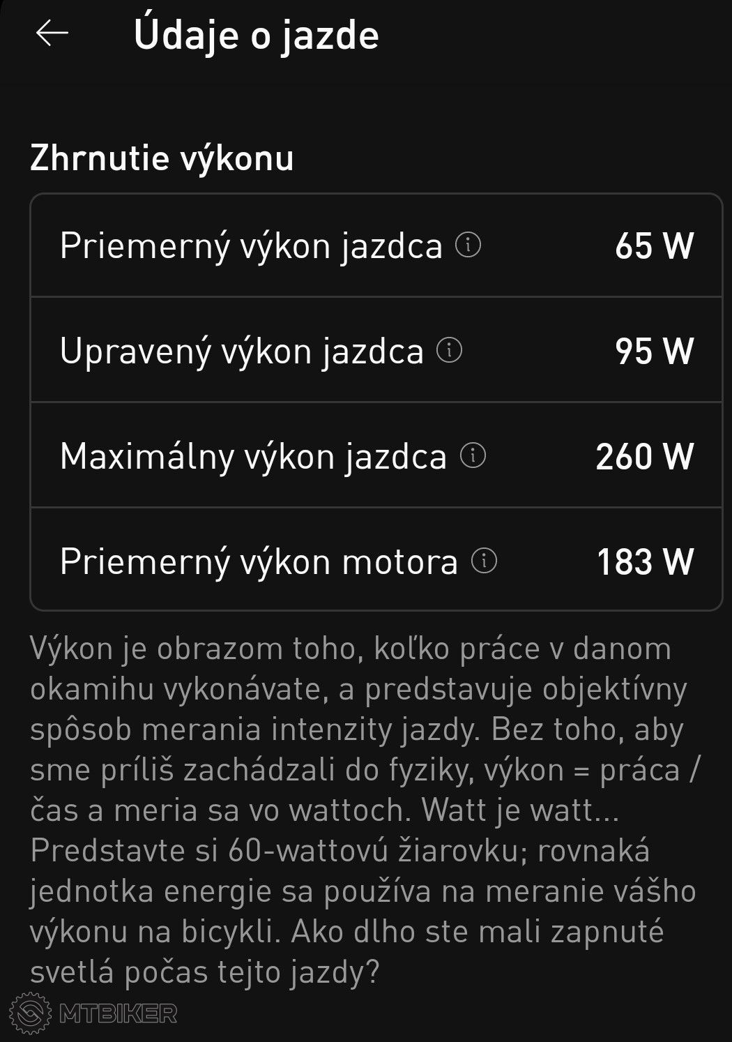

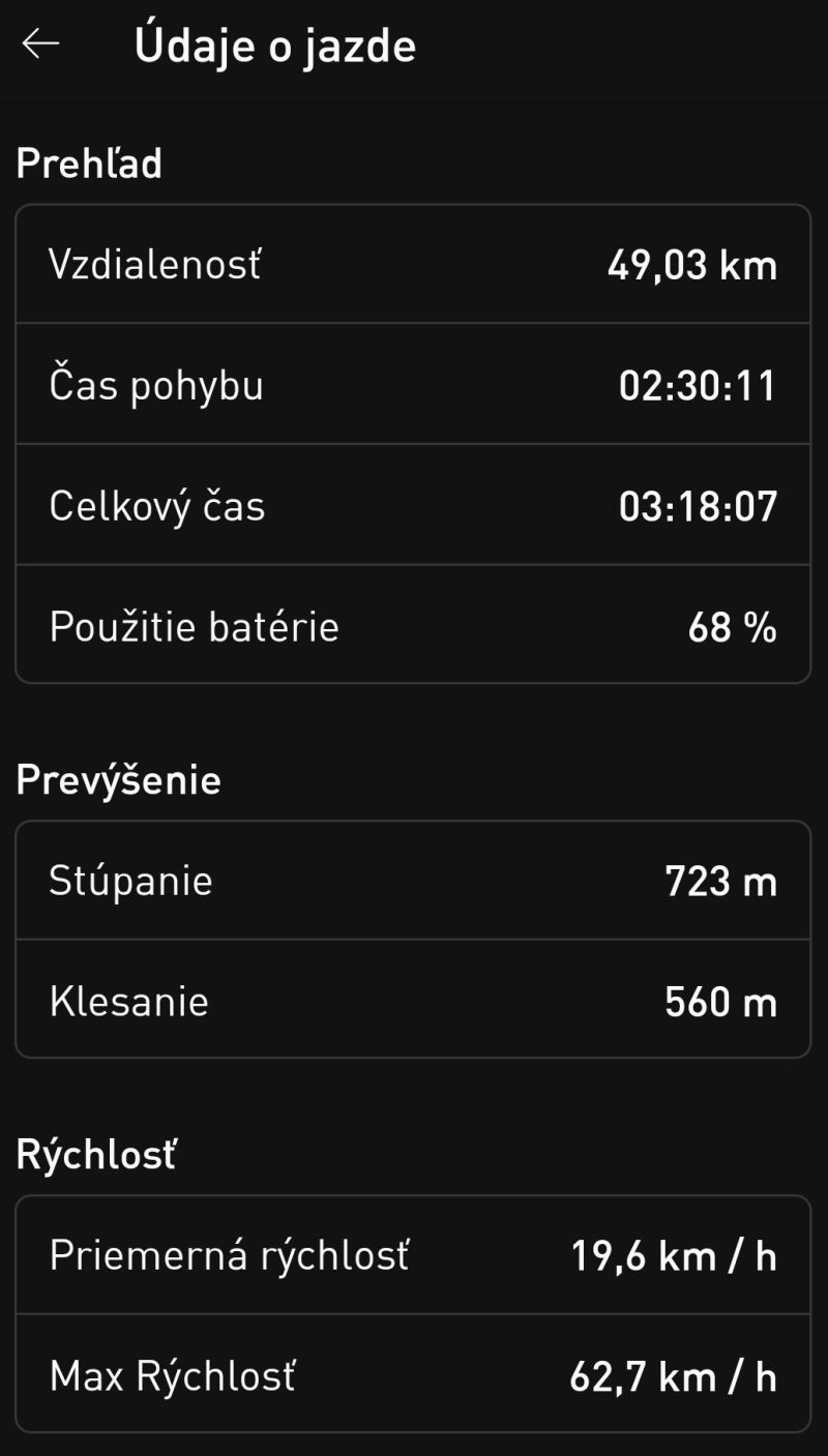

Z novej appky spešlu sa dá vyčítať kadečo.
Screenshot_2024-04-23-12-51-16-126_com.specialized.android.jpg 74.42 KiB thumb_up-1thumb_down
Screenshot_2024-04-23-12-51-26-177_com.specialized.android.jpg 145.03 KiB thumb_up0thumb_down
Screenshot_2024-04-23-12-51-32-840_com.specialized.android.jpg 92.93 KiB thumb_up0thumb_down
