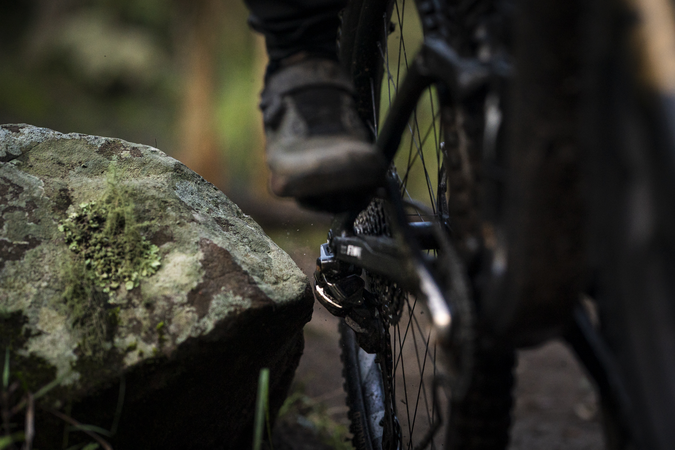

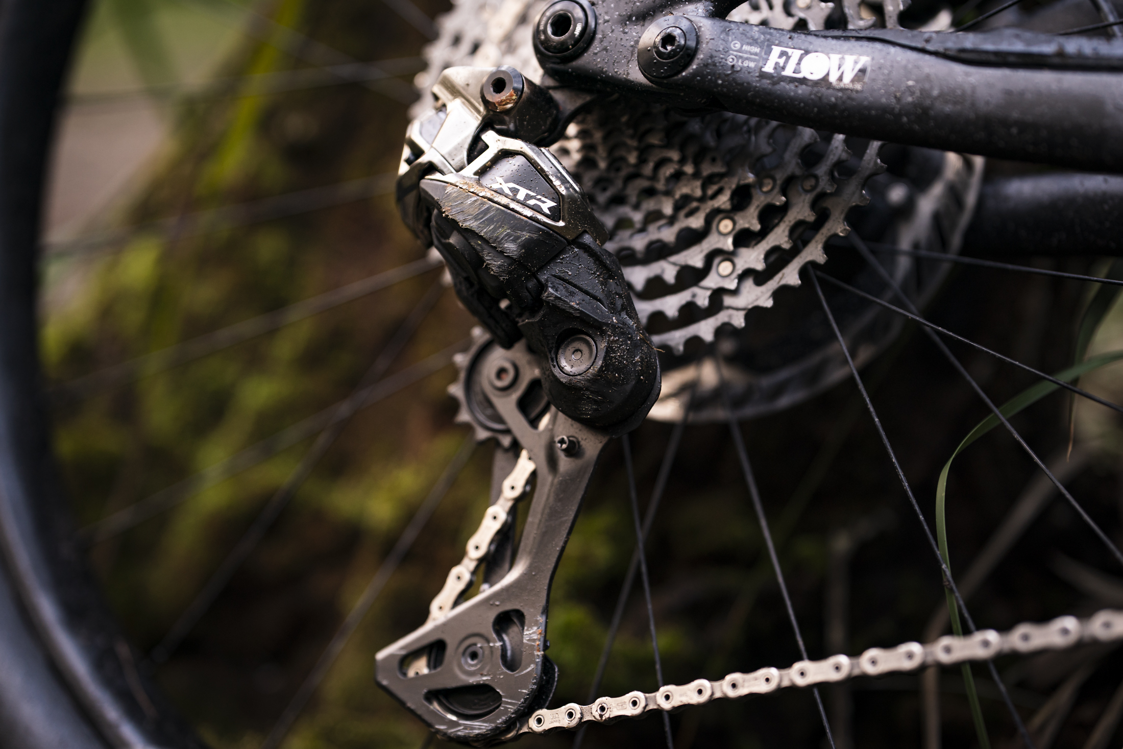

Teda dali tej prehadzovačke zabrať keď ju skúšali naschvál odraziť na tej skale.
"Having found the perfect rock in Newcastle, he went about deliberately and repeatedly smashing the derailleur to illustrate how it would (or wouldn’t) handle such an event. Watching the slow-motion footage back, you can clearly see the derailleur moving inboard as well as rotating backwards on the hanger. This is what allows it to get out of the way and reduce the chance of snagging."
