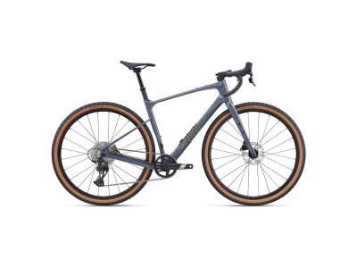

Špecifikácia
Rám
Rocky Mountain Smoothwall Carbon | BB386 | Zero Stack Tapered Headtube | Fully Guided Internal Cable Routing | Dropper Post Compatible | 142 mm Dropouts | SRAM UDH Compatible
Vidlica
Rocky Mountain Carbon Gravel | Full Carbon Steerer | 100x12 mm Axle | 3 Rack & Fender Mounts
Radenie
SRAM Apex AXS
Pre pravidelné a dlhšie jazdy
Prehadzovačka
SRAM Apex XPLR AXS
Kazeta
SRAM XPLR PG-1231 11-44T
Reťaz
SRAM Apex 12s
Kľuky
SRAM Apex 1 Wide | 42T | DUB Spindle | Crankarm Length: XS-SM = 170 mm | MD = 172.5 mm | LG-XL = 175 mm
Brzdy
SRAM Apex
Ráfiky
WTB KOM Team i23 TCS 2.0 | 28H |
Predný náboj
Rocky Mountain Sealed 12 mm
Zadný náboj
Rocky Mountain 12x142 mm
Špice
Pillar SR TB 2.2/1.8/2.0
Plášte
WTB Venture TCS Light Fast Rolling Dual DNA 700x40C
Sedlovka
Rocky Mountain SL 27.2 mm
Sedlo
WTB Silverado Race 142 | Cromoly Rails
Predstavec
Rocky Mountain 31.8 XC | 5° Rise | XS = 60 mm | SM = 70 mm | MD = 80 mm |LG = 90 mm | XL = 100 mm
Riadidlá
Rocky Mountain | Reach 75 mm | Drop 120 mm | Flare 16° | Width: 420 mm XS | 440 mm SM-MD | 460 mm LG-XL
Omotávka
Rocky Mountain Gel Bar Tape
Hlavové zloženie
FSA Orbit NO.57E | Sealed 36x45° Bearings | 30.2x41x6.5 mm Upper | 40x51.8x8 mm Lower | 1.5" Crown Race
Stredové zloženie
SRAM BB386 DUB Wide
Detaily produktu
Pohlavie Pánske, Unisex
Modelový rok 2024
Počet prevodov 1x12
Sada SRAM Apex AXS
Farba across the universe/stairway to heaven
Materiál karbón
Materiál kolies Hliník
Priemer kolies 28"
Brzdy Kotúčové hydraulické
Vidlica Pevná
ID produktu 343635
